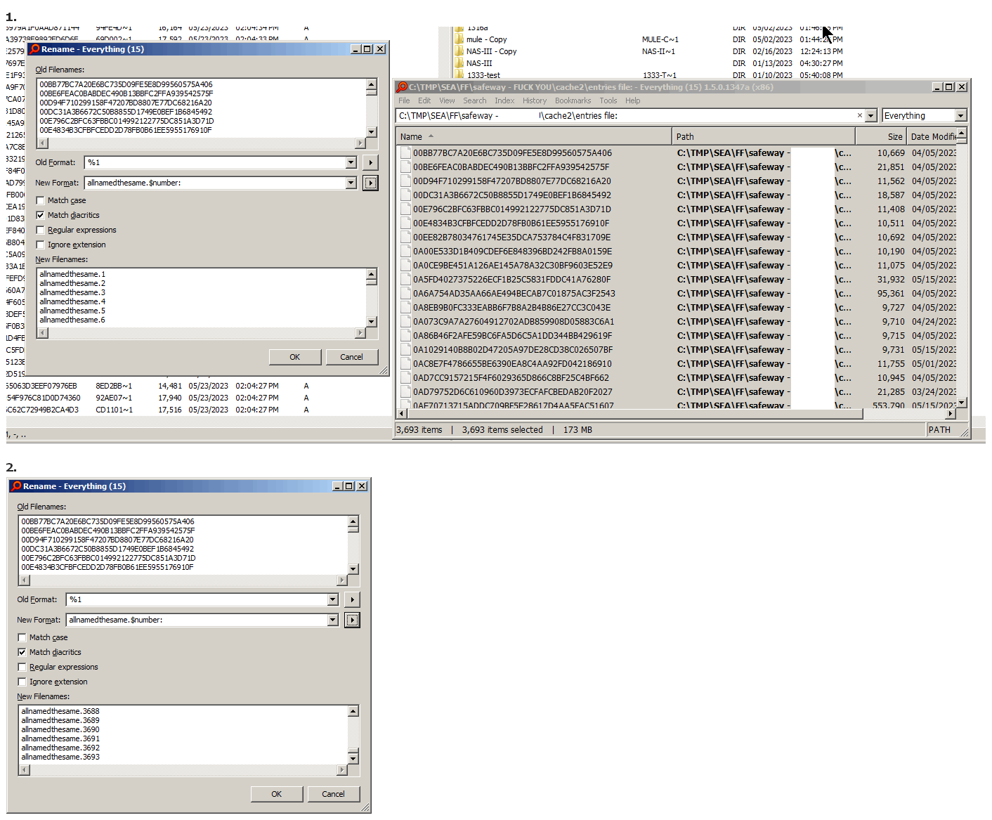

Re: Feature Request: Renaming all files in a group to one common name
I selected ~4000 files, in the same directory.
(In this case, I loaded the directory, directly, rather then pasting 4000 file names in [which would take MUCH longer to do].)
Selected all the files, & in the rename dialog, set the wanted file name to, "allnamedthesame", & added a "counter" (if you will) - $number:. So the files will be named, "allnamedthesame.counter", with counter in this case, being 1..4000.
(The "counter", would make the file names "unique" - even though they are "allnamedthesame", & that would get around any collision issue.)
Admin - Thank-you for the timely update. I look forward to playing with it....
