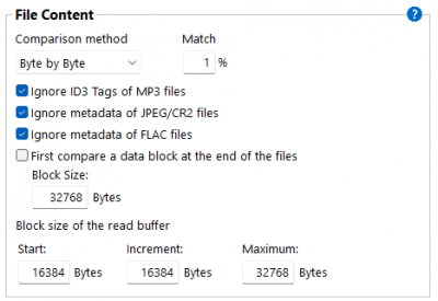

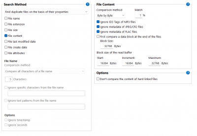

This has cost me some headaches... I just don't understand what I am doing wrong (in my head).

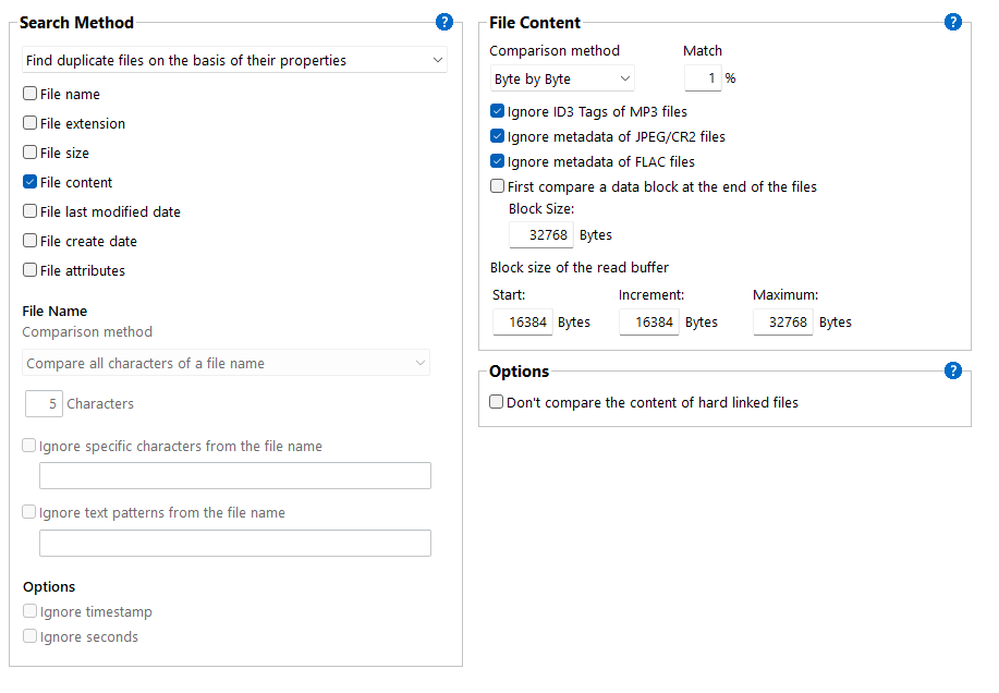

I have some identical (at first sight) video and image files (only a difference in size), but for some reason AllDup sees them as being different when doing a content search (byte by byte). Even if I set the byte to byte match to 1% they are still being seen as different. These files have the same filename and extension, so I could easily do a search for duplicates, but I am just trying to figure out why Alldup is doing what is does :P
My settings in this specific case.
The files not being seen as duplicates when comparing content, but in this screenshot only when comparing filename and extension.

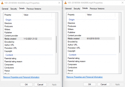

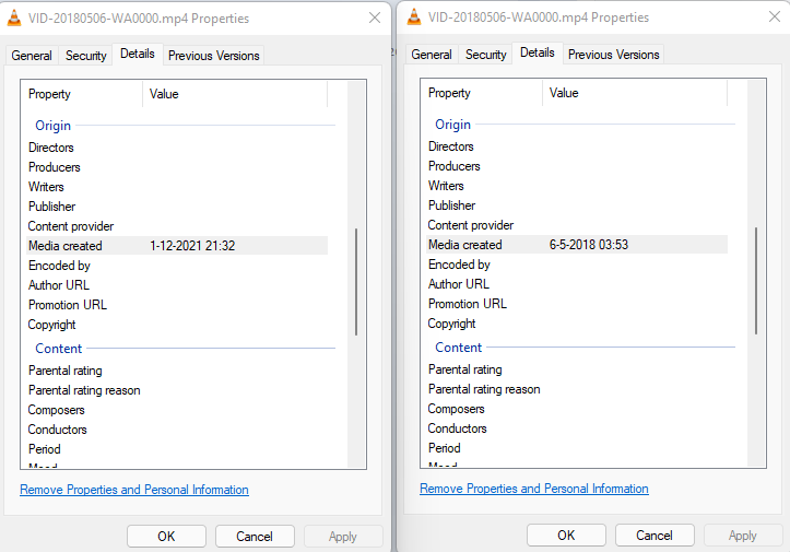

The only thing I can think about is the difference in the Media created date. I changed that.

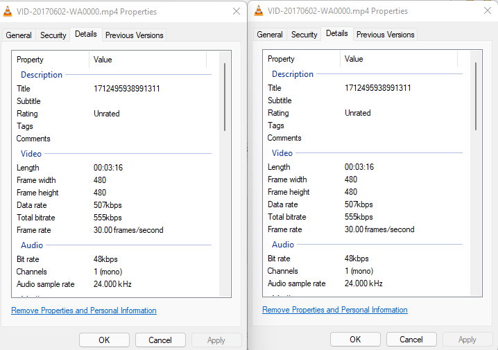

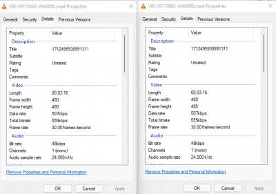

Condition 1 is met: I just checked both mp4 files and they have the same length: 00:03:16

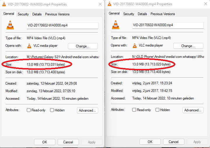

Is there a difference between the size of the file and the size of the file content?
The size is a little different, as shown in the picture above. But one condition for comparison is met based on the same length, so why is there a difference in file content? It's exactly the same video.

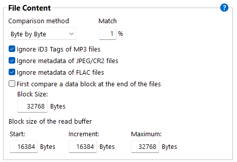

Also I couldn't find the option to exclude metadata for video files. I have only the options as shown below:
If I can exclude the metadata I think the size will be equal.

prennie4532 wrote: 14 Feb 2022, 18:03 Condition 1 is met: I just checked both mp4 files and they have the same length: 00:03:16
The condition 1 doesnt met because it's only about the file size and not about the file content type like the video or audio length.
prennie4532 wrote: 14 Feb 2022, 18:03 And if the file content isn't compared because the conditions aren't met, how can AllDup decide if the file is a duplicate or not?
The decision will be made by the choosen search method and options.
In your case it's relatively easy:
You use the search method "file content" and the file size of your files is not equal = no duplicates.
In your case (video files) it will be better to use the search method "Find video & audio files on the basis of the audio length".
