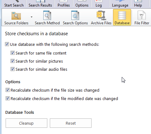

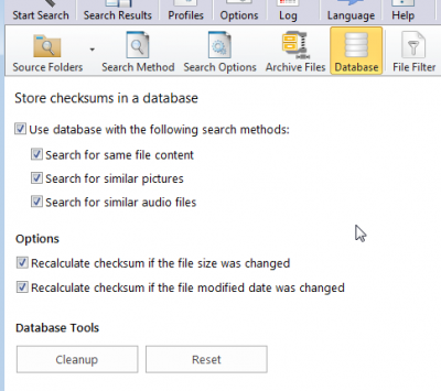

A new version with the database functionality is now available for download:
NEW: Now you can store the calculated checksums during a scan for duplicate files into a database. That has the advantage that further file scans requires considerably less time because of the reuse of the stored checksums.
NEW: Main Window / Toolbar: Added the button 'Database'.
NEW: Database: The storage of the checksums can be individually activated for the search methods 'File Content', 'Similar Pictures' and 'Similar Audio Files'.
NEW: Database: Option 'Recalculate checksum if the file size was changed'.
NEW: Database: Option 'Recalculate checksum if the file modified date was changed'.
NEW: Database / Tools: The button 'Cleanup' removes all checksums of files not exist anymore.
NEW: Database / Tools: The button 'Reset' removes all checksums at the database.
NEW: Database / Tools: The button 'New' deletes the current database file and creates a new database.
