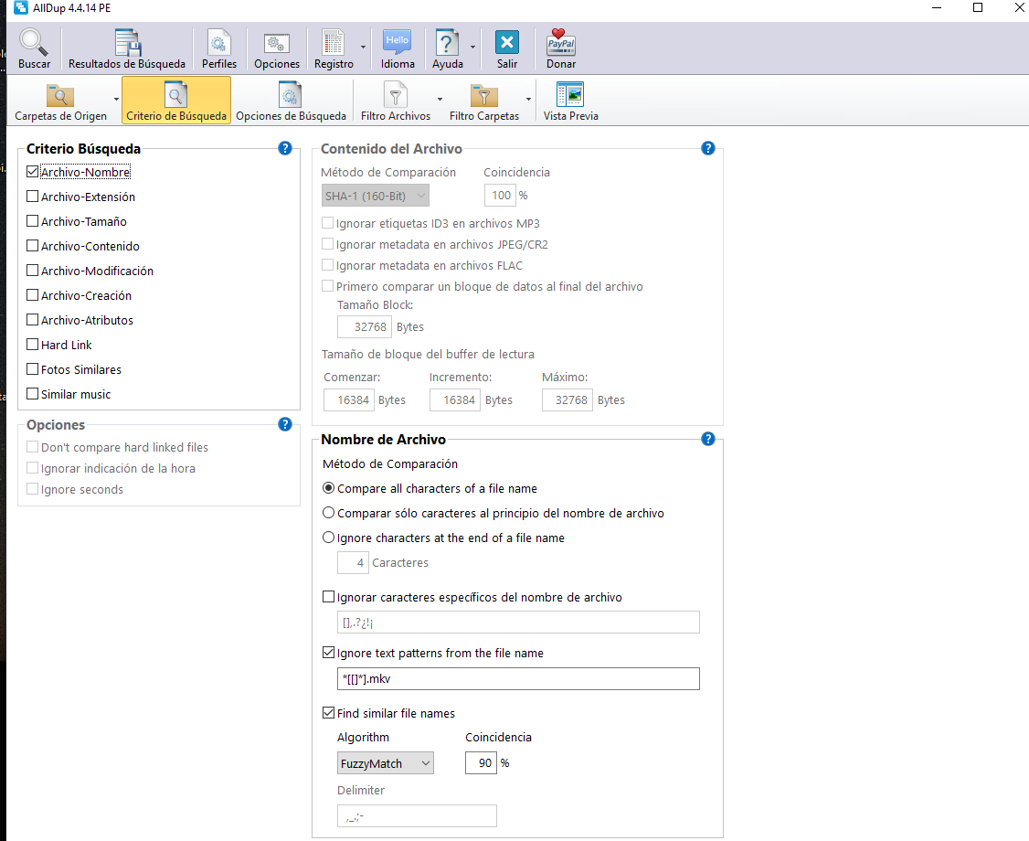

Hi, i try your command but Dont work. It Dont delete alls chars between [ ]
If I put in "ignore text patterns" this
1080/hevc/
This work. But I would like with [*] because i have too many patterns between []

And why Dont work you command?
*[[]*.mkv
Re: How to do it
your search pattern *[[]*.mkv is not correct.
the search pattern we have tested successfully is: *[[]*].mkv

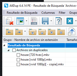

Post by sirfrancis18 »
hi
sorry. i wrote wrong the command in the forum
i try *[[]*].mkv
i attached image for your supervision
for alldub all files are uniques
Re: How to do it
We used the select command "Select files by name" with the pattern "*[[]*].mkv"...
You cant use this search pattern with the file name option from oyur screenshot.
