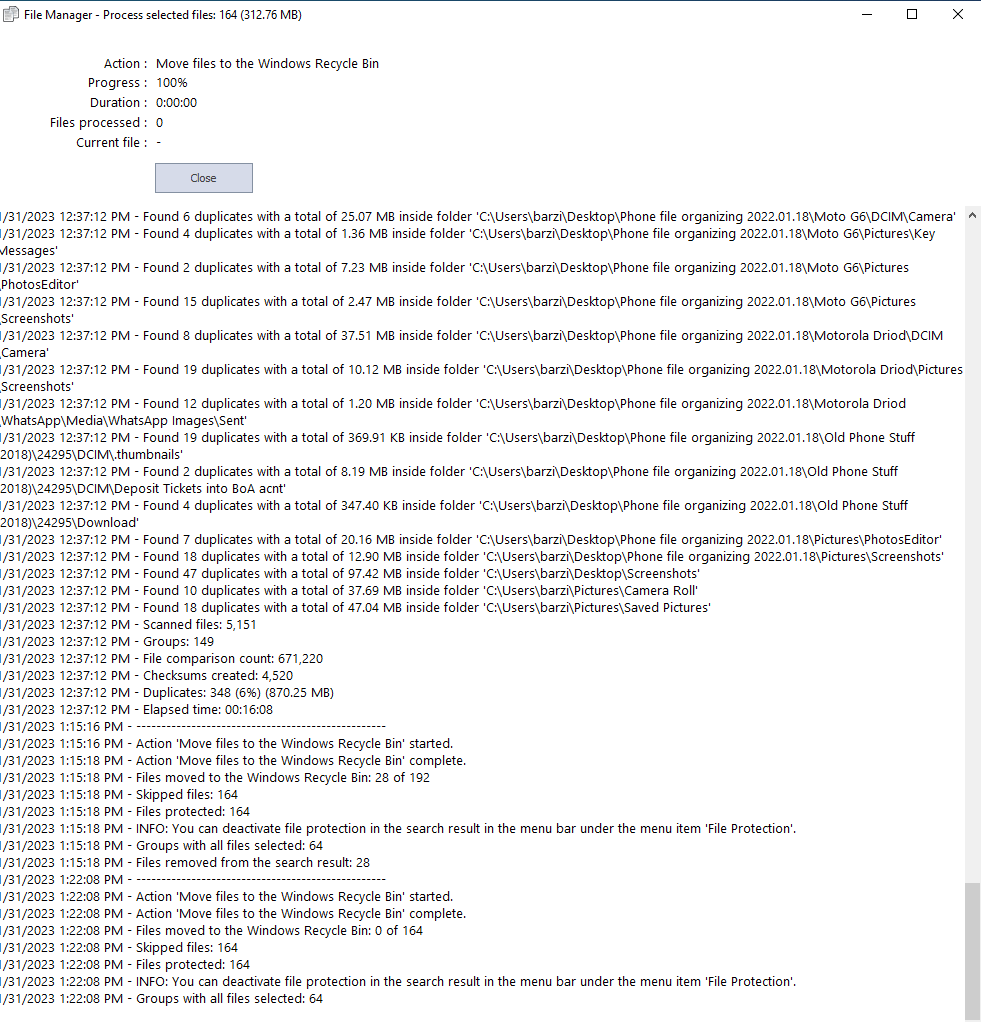

I've tried to change the protection mode with the Drop down in the File Protection mode, but it will not change the protection designation to let me delete the selected files. I have tried it with the check mark AND without the check mark. How do I fix this?

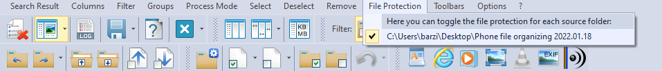

The checkmark indicates that the file protection is ON.
Remove the checkmark to turn OFF the file protection for a source folder.
With the next update a lock icon will be shown instead of the checkmark.

Unfortunately saving exiting and restarting did not work.

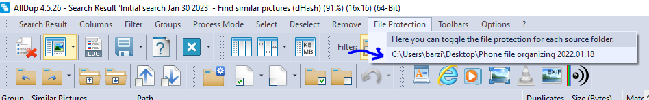

I'm wondering if it has to do with the "Main" search file and the "sub-files". I searched the main file and all sub-files. It seams like it deleted the pictures in the main file, but won't delete in the sub-files. If that's the case, is there a way to "un-protect" the sub-files post search? When in the File Protection pull down, I only get the main folder listed (per the attached pic). So I can't un-protect anything but the main file.

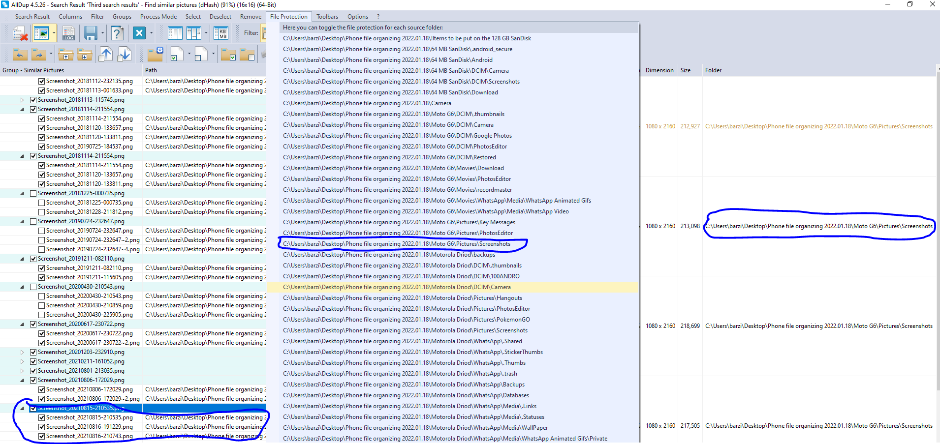

I've run another search and this time, from the beginning added the other files to be able to select/deselect as protected. per the attached pic, you can see the pathway of the picture is the same as the pathway that shows a fold that is unprotected, yet it will not delete the file. I've also attached the log.
Any help to trouble shoot this would be appreciated.

Protecting or unprotecting a source folder includes all files in the sub-folders too.M_Barz wrote: 01 Feb 2023, 01:20If that's the case, is there a way to "un-protect" the sub-files post search?
There is no need to add all sub-folders of the source folder to the source folder list.
