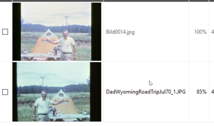

I just started using AllDup and it seemed to work but now when I compare two folders with known dups, it does not find any.
It looks like some of the pics are reversed, but this should not matter? I tried with various orientation options on and off.
I could send two of the dups to check?
AllDup not find dups

Thanks, here is a link to a few dups that don't get found, even when they are in the same folder.
https://www.dropbox.com/scl/fo/vtqf9pnl ... kkhb8&dl=0

I was not able to get Bild0014.jpg & DadWyomingRoadTripJul70_1.JPG to be seen as dups.
Oddly, Bild0003.jpg & Bild0007.jpg were often noted as "dups".
(I'm not particular proficient in picture dups, but I've been dabbling of late. With what I've been going though, I dropped the % to 93%, & that seems to be low enough to pick up wanted items while also returning relatively few false dups. If I dropped down to 83%, I'd guess I'd be in the realm of mostly false dups.)

i got this results with mHash:
Comparison method: mHash
Match: 80%
Detect picture modifications: Flipped horizontally
Re: AllDup not find dups
Thanks very much therube (glad the pics brought back happy memories for you too) and Admin (would not have known to use mHash).
