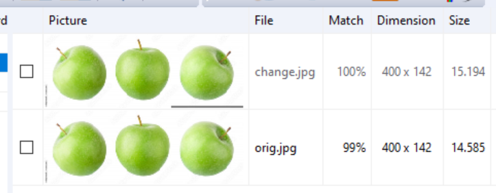

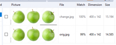

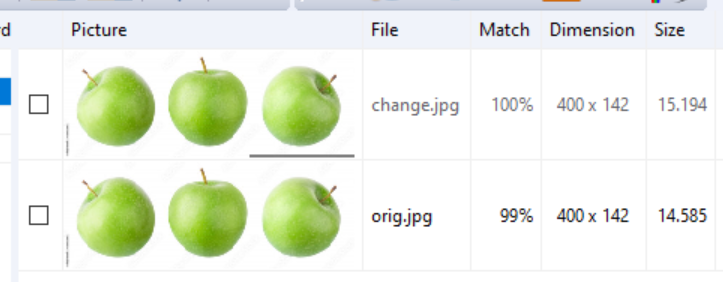

Two pics, "clearly" not "identical" visually.
SHA1 confirms that, says, not identical.
Yet, aHash (default settings) says, "100%"?
Re: Similar Pictures, explain concept of "100%"
For the comparison methods (...)Hash, the percentage match refers to the created hash value and not to the byte content of the image.
therube wrote: 21 Oct 2023, 03:24 Two pics, "clearly" not "identical" visually. SHA1 confirms that, says, not identical. Yet, aHash (default settings) says, "100%"?
This is due to the internal rounding up from 99.x to 100%.
The 100% issue with the xHash will be fixed with the next update:
