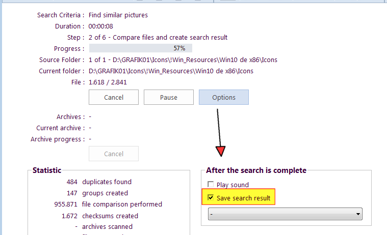

Do note that once a scan has finished, in the Results window, you are able to save those results (prior to doing anything else).after 7 hours it found 135,000 duplicates, man thats a lot.
Anyway it crashed and all my hard work was forgotten
Search Result -> Save (Save as)
Then, if you happen to crash, you can reload that saved search session (from the main AllDup) window.
Search Results -> Stored Search Results
(Maybe AllDup could have an option to automatically save the last Search?
And that would automatically be cleared on program Exit - except if there happened to be a crash, in which case it could be reloaded on restart.)
