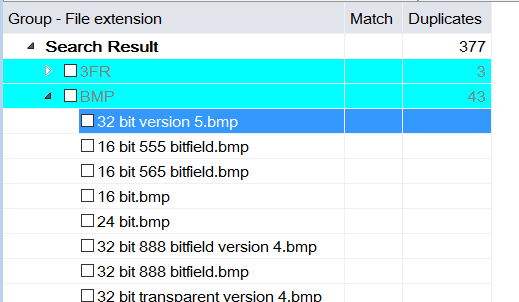

We added a new file context menu command:
Result:
Screenshot - 25.06.2021 , 07_42_48.png (10.33 KiB) Viewed 17350 times
