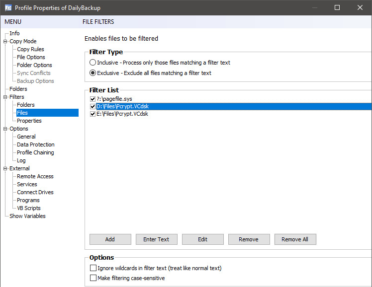

Please, how this case can be explained? :

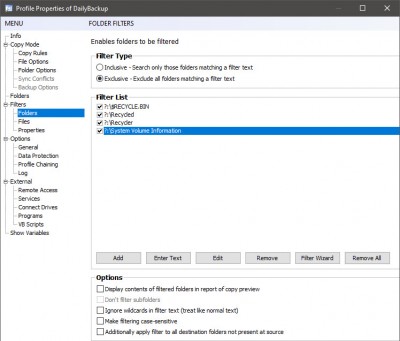

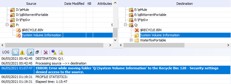

This folder, \System Volume Information, is filtered, as you can see here:

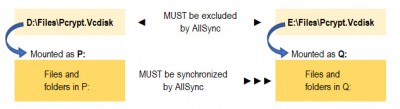

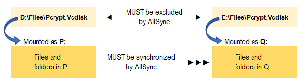

I have a similar case with a file, D:\Files\PCrypt.VCdsk. It contains an encrypted volume. This volume is always mounted as the P: disk unit. At 300 GB, it is not a candidate to be synchronized every day. It is better to synchronize its contents.
To make with AllSync the backup of this file, I mount E:\Files\PCrypt.VCdsk, the file in the AllSync's 'Destination' unit, as Q:. Then, I synchronize from P: to Q:. In this context, D:\Files\PCrypt.VCdsk and E:\Files\PCrypt.VCdsk should be excluded from any Synchronization process:

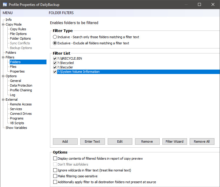

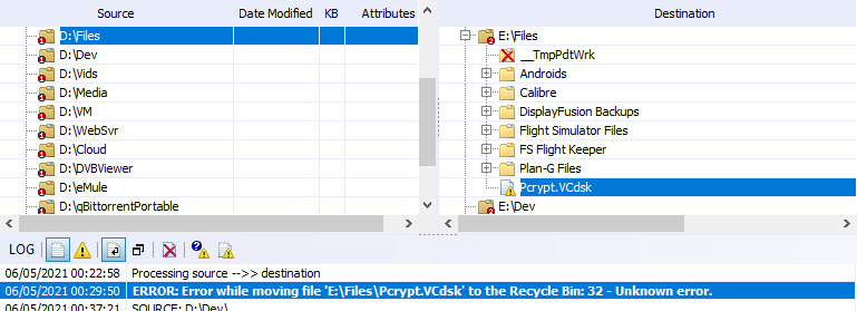

, but I get errors and I'm unable to set the filters properly:
I would be very grateful if you could give me a hand with these questions.

Excuse me. Repeating post from here, with images as attachments:
Hello,
Ivaneck
Posts: 5
Joined: 06 May 2021, 15:11
Re: Problems with filters
Post by Ivaneck »
Joan
AllSync 3.5.142 Business Edition

Administrator wrote: 06 May 2021, 19:29 Why do you want to exclude files from the drive D: and E: if you synchronize files from P: to Q: ?
These files in D: and E: are containers. They contain encrypted disk volumes, mounted as P: and Q:
VeraCrypt - Creates a virtual encrypted disk within a file and mounts it as a real disk.
https://www.veracrypt.fr/code/VeraCrypt
Perhaps with pictures it will be easier to understand the issue. If not, please do not hesitate to ask any questions you may have.

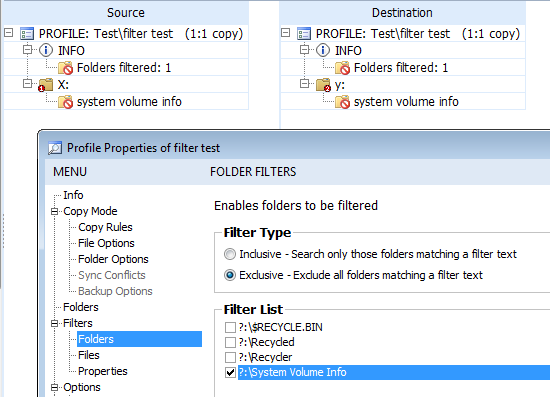

We tried to reproduce this error, but our filter is working fine:
Deactivate the 2. option at the rules for deleting files and folders:
delete rules.png (5.13 KiB) Viewed 54770 times
Ivaneck
Posts: 5
Post by Ivaneck »
It works!! Thanks!
