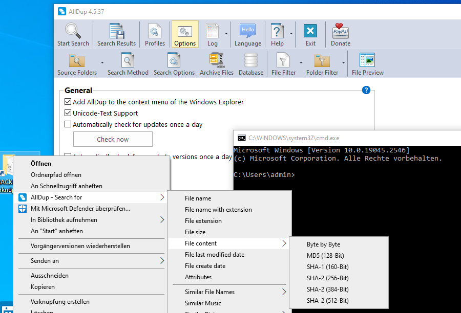

AllDup 4.5.37:
Please check if the files "config.xml" and "KuShellExtension64.dll" are present in the following folder: C:\ProgramData\AllDup
They are necessary for the windows explorer context menu.
