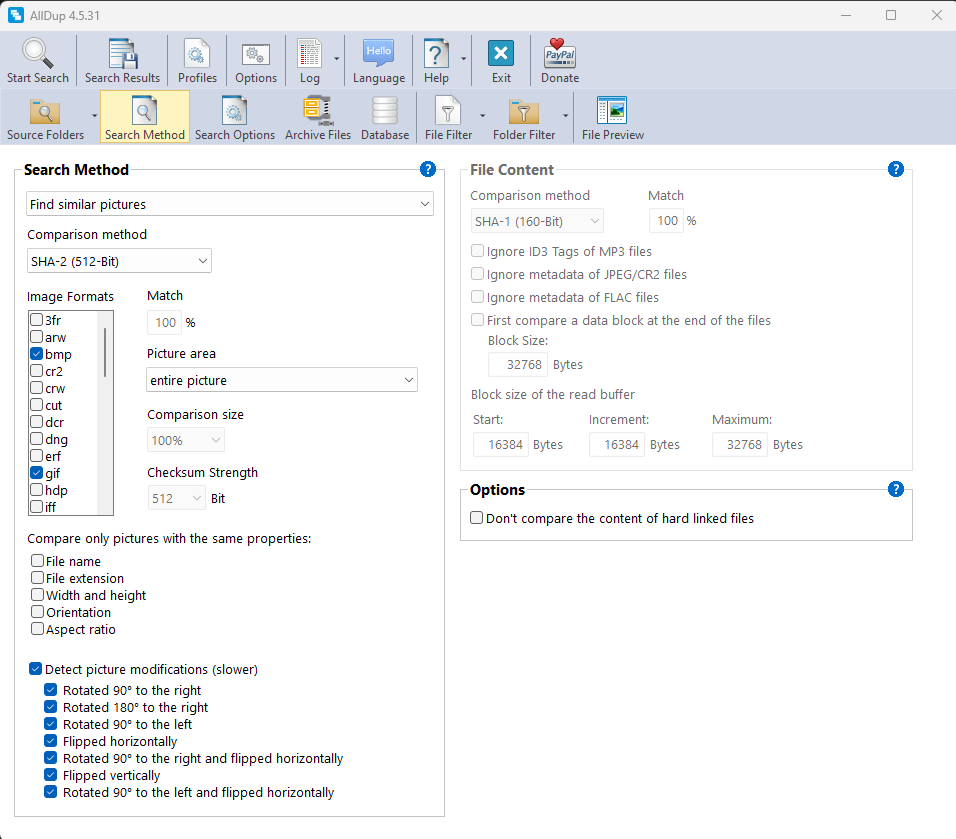

Below is screenshot from AllDup 4.5.31 comparing them:
Comparison settings for screenshot above:

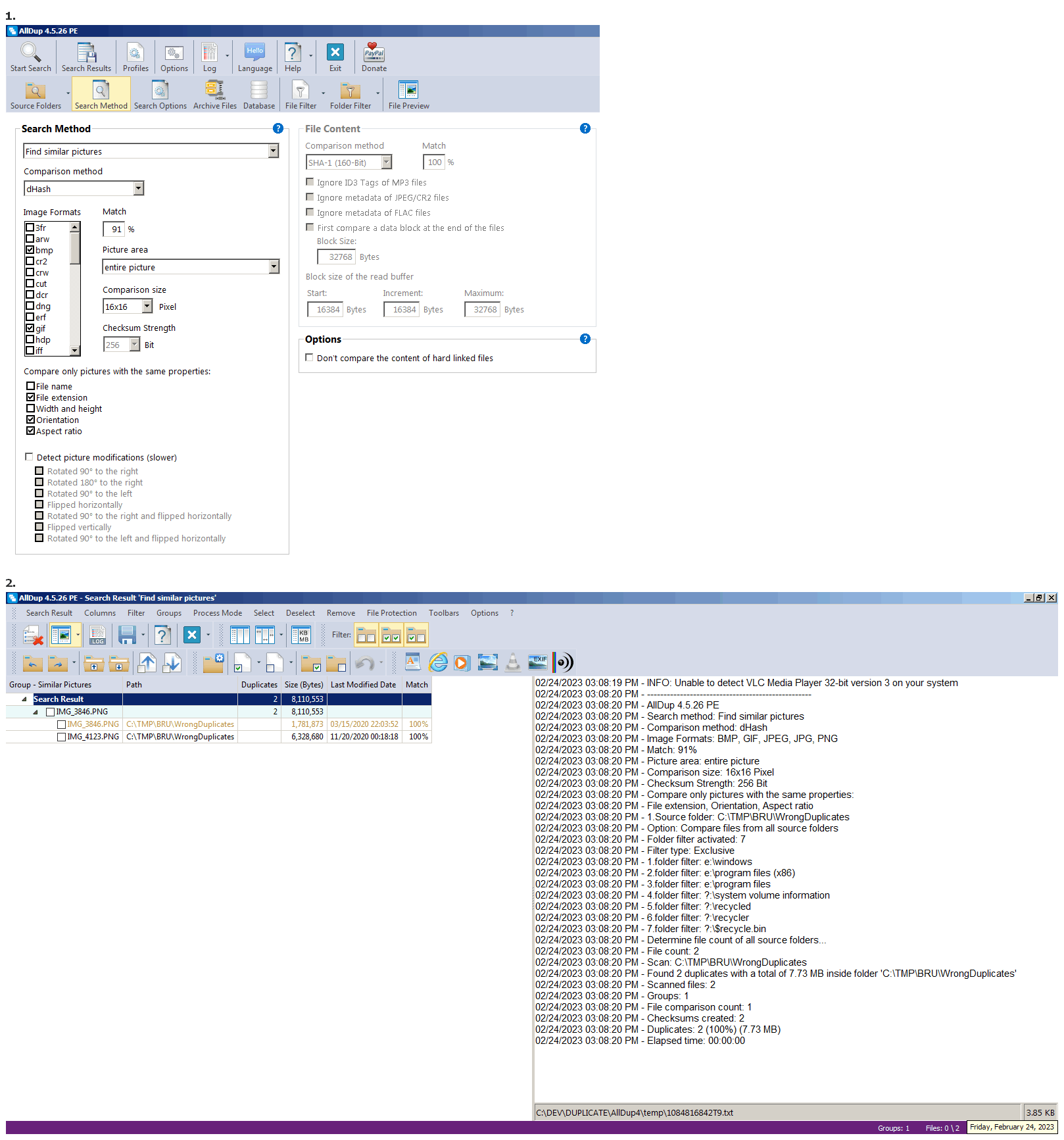

Well color me confused?
(I don't know that I've particularly run an Image dup search before ? & I'll assume these are default values?)
Anyhow, showing as 100% match, much less that it found dups, seems... odd?
